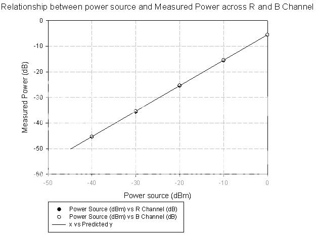

I started by trying to measure the input power at the R and B channel by changing the RF power source.
The RF source, R and B channel are connected to a two way power splitter. The setup is shown below.
I set the "meas" button to B to measure the power on the B channel and "meas" to R to measure the input power to the R channel.
The relationship of the output power from the RF source with the measured input power to the B channel are shown below.
I am a little confuse here. Why does the measured power at the R or B channel is larger than the RF power source?
For e.g., when the RF power source was set to -10dBm, I am measuring -15dB. Is -15dB the input power at the R or B channel or I have mistakenly understand the unit?
